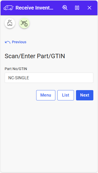

### **Enter Part No**
* Entered Part No should belong to the user’s default site and must be in transit.
* Click on the **List** button to see a list of parts that are in transit on the user’s default site.
| <img src="https://3218748546-files.gitbook.io/~/files/v0/b/gitbook-x-prod.appspot.com/o/spaces%2F-MiW42YxFsGXIDjQJKNR%2Fuploads%2FYRwArKjgJWNLmGozKpdd%2Fimage.png?alt=media&amp;token=fcd0e6ee-464f-4757-8d4b-138ad2dad3ff" alt="" data-size="original"> | <img src="https://3218748546-files.gitbook.io/~/files/v0/b/gitbook-x-prod.appspot.com/o/spaces%2F-MiW42YxFsGXIDjQJKNR%2Fuploads%2FvZTTVqpnmmP6yMiANbHS%2FPicture105.jpg?alt=media&amp;token=76f1ca33-f676-469e-a0b1-a8ca5178b5c0" alt="" data-size="original"> |
|                                                                                                                        Flow Connect                                                                                                                       |                                                                                                                          Flow Classic                                                                                                                          |
**Pin Step:**
*Based on the selected Part user might be prompted with additional user steps to filter out* **Receive from Transit** *records until a unique record is selected.*

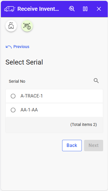

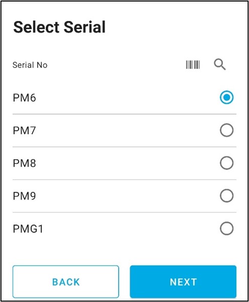

### Select Serial No
* Only shown if the selected Part is a Serial Part and the selections in previous steps result in more than one unique row for **Serial No** in ***Receive from Transit.***

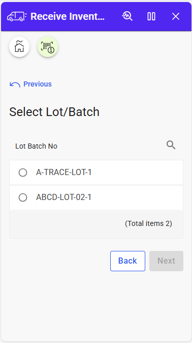

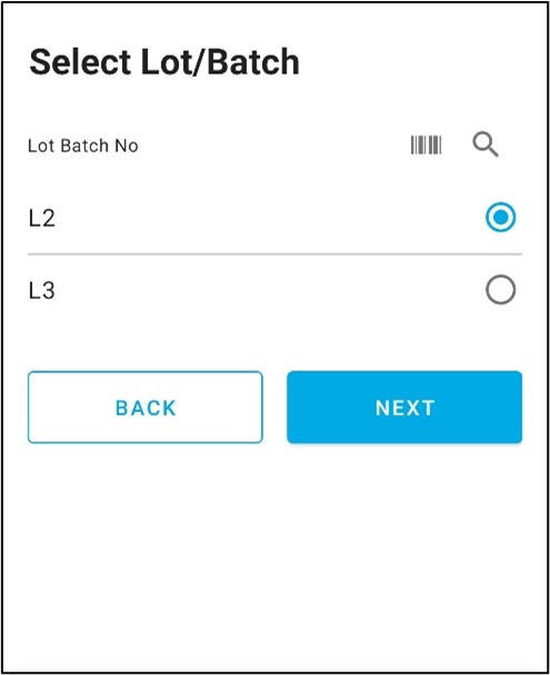

### Select Lot/Batch No
* Only shown if the selected Part is Lot/Batch enabled and the selections in previous steps result in more than one unique row for **Lot/Batch No** in ***Receive from Transit.***
