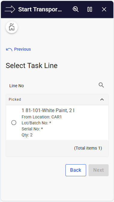

### Enter Task Line No
* Select a Task Line to start processing.
* After a Task Line is processed the flow will loop back to this step to start with another line. This will continue until no lines are left to process for the given Transport Task. However, you can choose to exit the process at any time.
Based on the selected Task Line user will be prompted with additional user steps. If the line is handling unit connected then it will start [Process Handling Unit on Transport Task](/marketplace-documentation/applications/explore-apps/ifs/warehouse-management/documentation/ifs-application-10/warehouse-handling/process-handling-unit-on-transport-task.md) flow, otherwise it will start the [Process Part on Transport Task](/marketplace-documentation/applications/explore-apps/ifs/warehouse-management/documentation/ifs-application-10/warehouse-handling/process-part-on-transport-task.md) flow.
