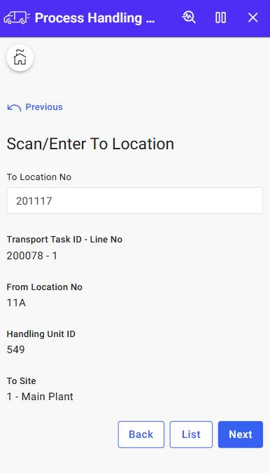

### **Enter To Location No**
* From Location No is required and validated against transport task lines filtered by the Transport Task ID entered in the previous step.
* Click on the **List** button to see a list of From Location No’s used in transport task lines for the given Transport Task.
| <img src="https://3218748546-files.gitbook.io/~/files/v0/b/gitbook-x-prod.appspot.com/o/spaces%2F-MiW42YxFsGXIDjQJKNR%2Fuploads%2FtKSO42mFKhxHTbR6g9da%2Fimage.png?alt=media&amp;token=6d889a46-116e-4d92-958b-b85c84afb433" alt="" data-size="original"> | ![](https://3218748546-files.gitbook.io/~/files/v0/b/gitbook-x-prod.appspot.com/o/spaces%2F-MiW42YxFsGXIDjQJKNR%2Fuploads%2FOybC8yTyhZCw3ygA097u%2FPicture103.jpg?alt=media\&token=9475faa6-30a3-406c-b053-6afaa73ebce5) |
|                                                                                                                        Flow Connect                                                                                                                       |                                                                                                       Flow Classic                                                                                                       |

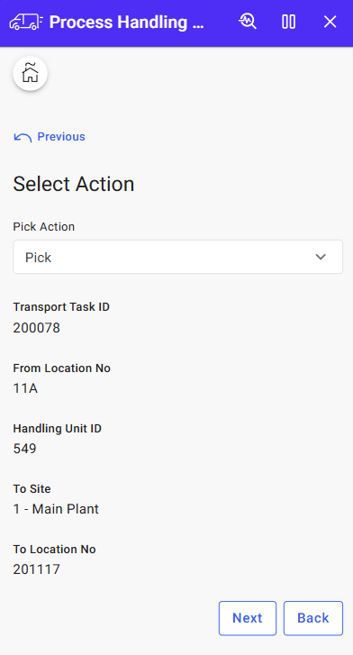

### **Select Action**
* Pick Action depends on the task line state.
* If the task line is in the Created state it will show ***Pick,*** ***Execute.***
* If the task line is already in the Picked state it will show ***Unpick,*** ***Execute***.
* Click on the **Save** button to complete the process.
| <img src="https://3218748546-files.gitbook.io/~/files/v0/b/gitbook-x-prod.appspot.com/o/spaces%2F-MiW42YxFsGXIDjQJKNR%2Fuploads%2FEBcx4UbMV6MsKYnDUc00%2Fimage.png?alt=media&amp;token=fe35b8e4-fdf0-4f6c-96be-e412bc1ef975" alt="" data-size="original"> | ![](https://3218748546-files.gitbook.io/~/files/v0/b/gitbook-x-prod.appspot.com/o/spaces%2F-MiW42YxFsGXIDjQJKNR%2Fuploads%2FZeXqBdgbuaGlekjhiZhi%2FPicture104.jpg?alt=media\&token=1e7cfe7a-8dc8-4dd4-9eaa-5feb8451b7e7) |
