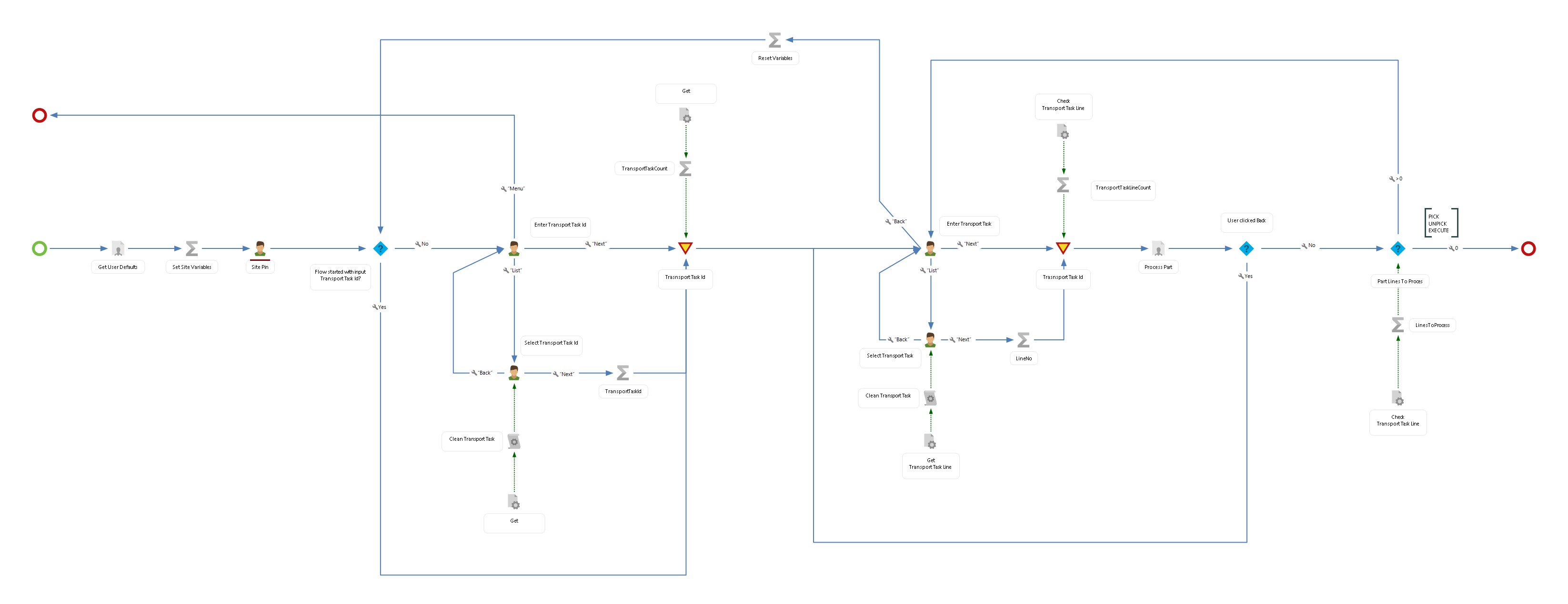

This flow (app) can be used to process Parts in a transport task.
<figure><img src="https://3218748546-files.gitbook.io/~/files/v0/b/gitbook-x-prod.appspot.com/o/spaces%2F-MiW42YxFsGXIDjQJKNR%2Fuploads%2FVQVEJoGwLhISQzdRGvtN%2FProcess%20Part%20on%20Transport%20Task%20Cloud.png?alt=media&amp;token=793291f1-e86d-4e8c-abc6-e665614259b7" alt=""><figcaption></figcaption></figure>

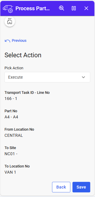

### **Select Action**
* Pick Action depends on the task line state.
* If the task line is in the Created state it will show ***Pick,*** ***Execute.***
* If the task line is already in the Picked state it will show ***Unpick,*** ***Execute***.
* Click on the **Save** button to complete the process.
  | <img src="https://3218748546-files.gitbook.io/~/files/v0/b/gitbook-x-prod.appspot.com/o/spaces%2F-MiW42YxFsGXIDjQJKNR%2Fuploads%2FBzdLVMBO1ANQU4FICWK0%2Fimage.png?alt=media&amp;token=885a50f9-79b5-4e56-bf2a-3dccc43bcc03" alt="" data-size="original"> | <img src="https://3218748546-files.gitbook.io/~/files/v0/b/gitbook-x-prod.appspot.com/o/spaces%2F-MiW42YxFsGXIDjQJKNR%2Fuploads%2FL5UHrsZDs8qK7WCtK5Am%2FPicture97.jpg?alt=media&amp;token=8b018310-adad-4f4a-ba7a-0aa4cd2480d6" alt="" data-size="original"> |
