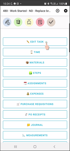

## Included Workflow Fragments(Components)
As a Field Technician I can perform the following on the selected Work Task:
* **Edit Task** and *General Information*, *Planning Information,* *Contact Information*
* Create, delete, update *Person* and *Tool/Equipment* **Time**
* Create, delete, update **Material Requisitions** and **Issue** *automatically* or *manually*
* Create, delete, update, and change the status of **Task Steps**

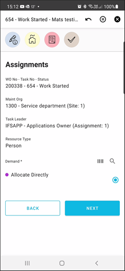

* Create, delete, and change the status of *Person* or *Tool/Equipment* **Assignments**
* Create, delete Work Task **Expenses**:

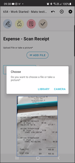

  * *Create manually* and add to Expense Sheet
  * *Scan a receipt* and add to Expense Sheet
  * *Add milage* to Expense Sheet
  * *Add transaction* to Work Task
* Create, delete, update, and change the status of **Purchase Requisitions**
* Register arrivals of **Purchase Orders**
* View Work Assignment **Journal**
* Add **Measurements** and show the history as a graph via Pinned Info
* Create, delete, update, and receive **Returns** (material)
* Update General Information for the connected *Serial* or *Functional* **Object**
* Update **Closure Information** and create/e-mail **Debrief** **Report** as a PDF file
* Contact a user and ask for **Remote Assistance** via *Help Lightning App*

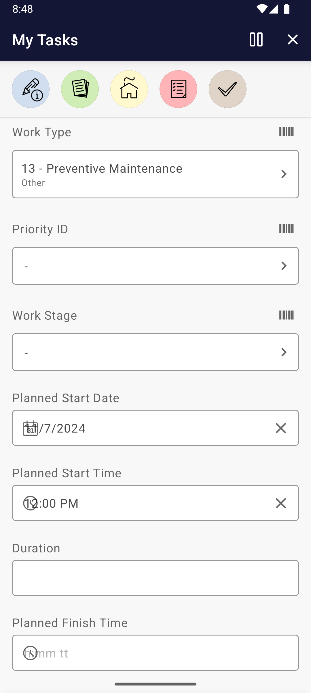

## Edit Task
Edit Task – General Information, Planning Information, and Contact Information.
*The complete overview of the flow fragment(component):*
{% file src="/files/G6qPiYTVndhPv7DhTUkH" %}
* Change ***Status\****
* Enter ***Description\****
* Long Description
* Actual Object ID
* Enter ***Maintenance Organization\****
* Work Type
* Priority ID
* Work Stage
* Planned Start Date
* Planned Start Time
* Duration in hours (*this can be used to calculate the Planned Finish Date/Time*)
* Planned Finish Date
* Planned Finish Time
* Earliest Start Date
* Earliest Start Time
* Latest Finish Date
* Latest Finish Time
* Contact
* Phone No
* E-mail
Press \[***Save***] to save the changes.
Press \[*Menu*] to go back to the menu.

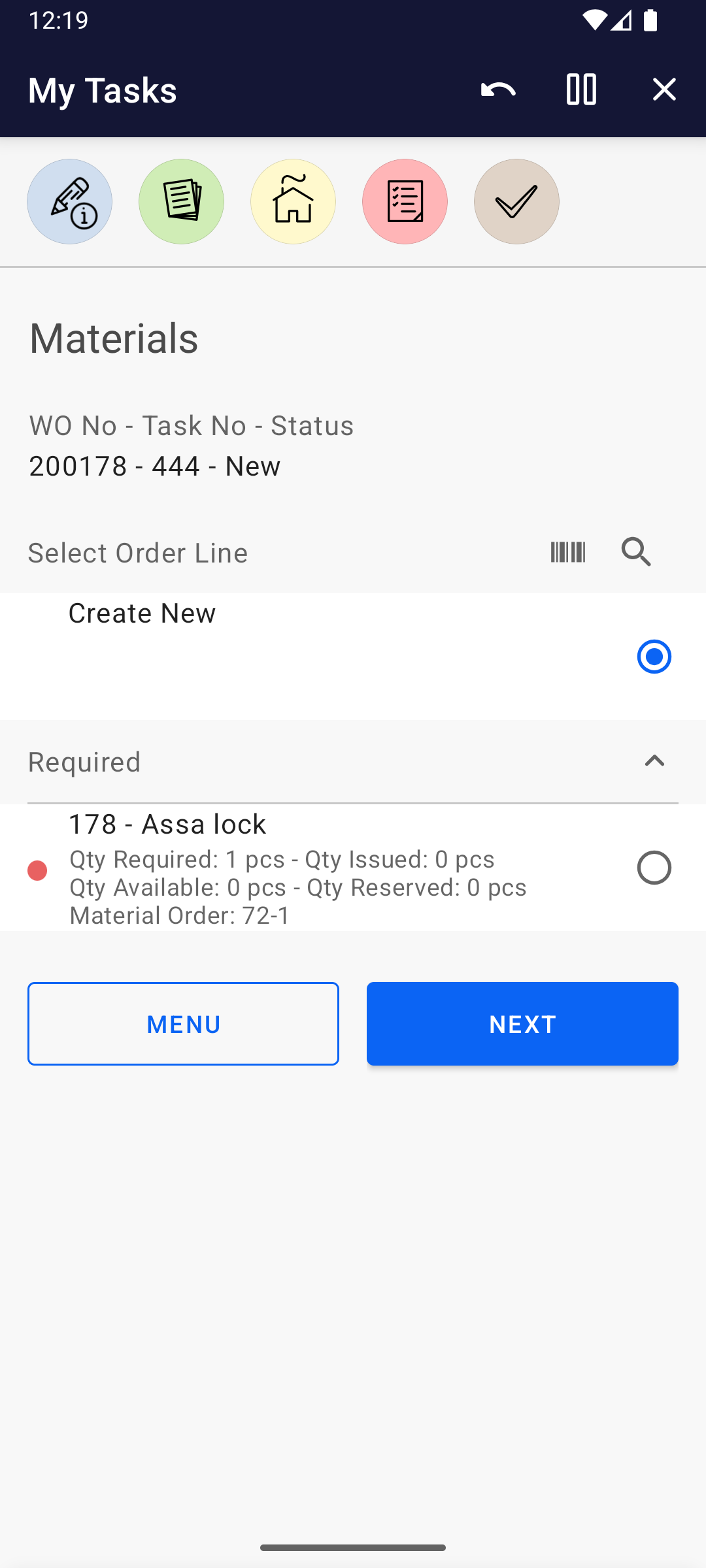

## &#x20;Materials
Create, delete, update **Material Requisitions** and **issue** them *automatically* or *manually*.
{% file src="/files/TdNvCMLCMEb3cuJJz5uy" %}
{% file src="/files/TVexHEaCEgNkeQi9zdue" %}
You can:
* Create New Material Requisition line
* Edit Material Requisition line
* Issue automatically or manually
* Delete Material Requisition line
|         <img src="https://3218748546-files.gitbook.io/~/files/v0/b/gitbook-x-prod.appspot.com/o/spaces%2F-MiW42YxFsGXIDjQJKNR%2Fuploads%2FFDvhNkhHdwJtR196VHAX%2Fimage.png?alt=media&amp;token=f2af3ba4-e849-4d8c-8fb2-0c4d710477f8" alt="" data-size="original">         | <img src="https://3218748546-files.gitbook.io/~/files/v0/b/gitbook-x-prod.appspot.com/o/spaces%2F-MiW42YxFsGXIDjQJKNR%2Fuploads%2FxJmim2O9agxjxD6BubcW%2Fimage.png?alt=media&amp;token=59b42d49-fb02-4b6a-b23d-1fba0698119a" alt="" data-size="original"> |
| <img src="https://3218748546-files.gitbook.io/~/files/v0/b/gitbook-x-prod.appspot.com/o/spaces%2F-MiW42YxFsGXIDjQJKNR%2Fuploads%2FEQuOergsmIScqzPhwoMo%2FScreenshot_1741934975.png?alt=media&amp;token=1a989bb2-8671-43ab-8e17-fc844f98a260" alt="" data-size="original"> | <img src="https://3218748546-files.gitbook.io/~/files/v0/b/gitbook-x-prod.appspot.com/o/spaces%2F-MiW42YxFsGXIDjQJKNR%2Fuploads%2FFmu6g2YZ4lE96ZivcyNF%2Fimage.png?alt=media&amp;token=0da00ce4-7af1-46b2-98ac-943f4ff47295" alt="" data-size="original"> |
|                                                                                                                                Flow Connect                                                                                                                               |                                                                                                                        Flow Classic                                                                                                                       |
### Create New Material Requisition
* Select ***Part Number(s)\****
* Enter ***Quantity\****
* Enter ***Required Date\****
Press \[***Save***] to save the record.
Press \[*Back*] to go back.
| <img src="https://3218748546-files.gitbook.io/~/files/v0/b/gitbook-x-prod.appspot.com/o/spaces%2F-MiW42YxFsGXIDjQJKNR%2Fuploads%2Fqvuzck7OpufZHOrUj6tK%2FScreenshot_1741935046.png?alt=media&amp;token=0b7a71ab-3d72-444e-a108-b2bb2adf4a50" alt="" data-size="original"> | <img src="https://3218748546-files.gitbook.io/~/files/v0/b/gitbook-x-prod.appspot.com/o/spaces%2F-MiW42YxFsGXIDjQJKNR%2Fuploads%2FBUT2b3Q2YdBozOI5iKcs%2Fimage.png?alt=media&amp;token=83f4e111-4866-4c9d-b674-b8bdb7135fd9" alt="" data-size="original"> |
| <img src="https://3218748546-files.gitbook.io/~/files/v0/b/gitbook-x-prod.appspot.com/o/spaces%2F-MiW42YxFsGXIDjQJKNR%2Fuploads%2F6nElCLPiuWzCTP3pdUBd%2FScreenshot_1741935118.png?alt=media&amp;token=8b60deb6-9789-4d7b-ad6c-02640d6a8d97" alt="" data-size="original"> | <img src="https://3218748546-files.gitbook.io/~/files/v0/b/gitbook-x-prod.appspot.com/o/spaces%2F-MiW42YxFsGXIDjQJKNR%2Fuploads%2FJhLUe7uxRGlUOdd6ZW37%2Fimage.png?alt=media&amp;token=9269823d-af1d-46a5-b9b3-75dfa6ec32c0" alt="" data-size="original"> |
### Edit Material Requisition
Press \[***Save***] to update the Material Requisition line.
Press \[*Delete*] to delete the Material Requisition line.
Press \[*Issue Automatically*] to issue automatically.
Press \[*Issue Manually*] to issue manually.

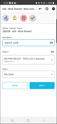

### Create New Task Step
* Select ***Object\****
* Status (‘*Not Done’ is the default*)
Press \[***Next***] to add save the Task Step.
