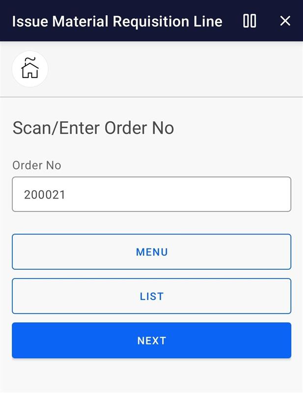

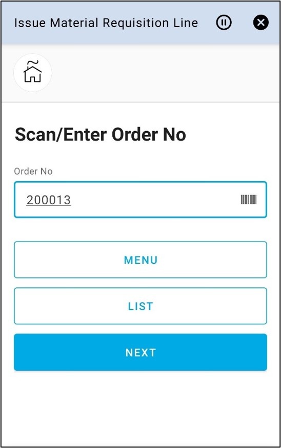

### **Enter Order No**
* Material Requisition Order Number is required and should be in status **Released**, **Partially Delivered** or **Reserved**.
* Click on the **List** button to see a list of material requisitions that satisfy the above condition.

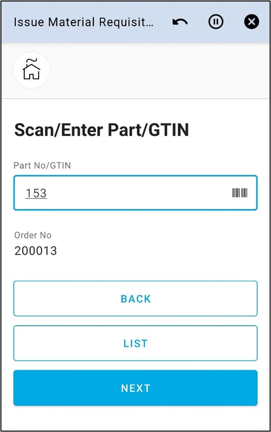

### **Enter Part No**
* Part No is required and should belong to the requisition entered in the previous step.
* Click on the **List** button to see a list of parts that satisfy the above condition.
