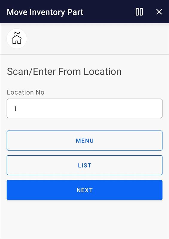

### Enter From Location
* From Location is required.
* Click on the **List** button to see a list of locations.
**Pin Step:**
| <img src="https://3218748546-files.gitbook.io/~/files/v0/b/gitbook-x-prod.appspot.com/o/spaces%2F-MiW42YxFsGXIDjQJKNR%2Fuploads%2FS7vI4yAKxq2VycDsNfCF%2Fimage.png?alt=media&amp;token=2e90a72c-519f-40a0-8ad9-c19c84697cca" alt="" data-size="original"> | ![](https://3218748546-files.gitbook.io/~/files/v0/b/gitbook-x-prod.appspot.com/o/spaces%2F-MiW42YxFsGXIDjQJKNR%2Fuploads%2Fdqk6Spo5w5OGHPbOYsGU%2FPicture15.png?alt=media\&token=ba4cc956-0a82-461e-9936-7399bce69b0f) |
|                                                                                                                        Flow Connect                                                                                                                       |                                                                                                       Flow Classic                                                                                                      |
