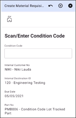

### **Enter Condition Code**
* Only visible if the selected part is a condition code enabled part.
* Click on the **List** button to see a list of condition codes.
