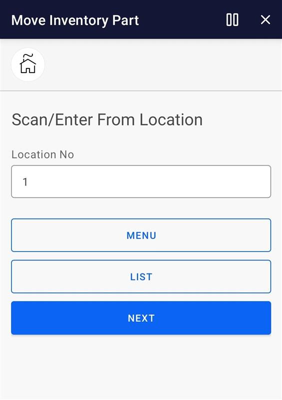

### Enter From Location
* From Location is required.
* Click on the **List** button to see a list of locations.

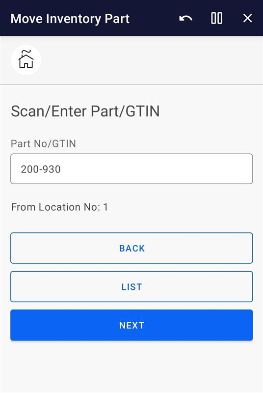

### Enter Part/GTIN
* Part No is mandatory and should exist in the From Location entered in the previous step.
* Click on the **List** button to see a list of parts that satisfy the above condition.
| <img src="https://3218748546-files.gitbook.io/~/files/v0/b/gitbook-x-prod.appspot.com/o/spaces%2F-MiW42YxFsGXIDjQJKNR%2Fuploads%2Fat5Axdix8F23MzKyz6F2%2Fimage.png?alt=media&amp;token=009c0e76-eb94-4eb9-9890-5c67718c3d08" alt="" data-size="original"> | ![](https://3218748546-files.gitbook.io/~/files/v0/b/gitbook-x-prod.appspot.com/o/spaces%2F-MiW42YxFsGXIDjQJKNR%2Fuploads%2FRwgxvqp9LBrNzhpH0ZIh%2FPicture17.jpg?alt=media\&token=c9e756ca-7feb-4b04-a39d-522aa57a9d54) |
|                                                                                                                        Flow Connect                                                                                                                       |                                                                                                       Flow Classic                                                                                                      |
*Based on the selected Part user might be prompted with additional user steps to filter out **Inventory Part In Stock** records until a unique stock record is selected. For more info about these additional steps please refer to* [*Inventory Part In Stock Selection*](/marketplace-documentation/applications/explore-apps/ifs/warehouse-management/documentation/ifs-application-10/inventory-part-in-stock-selection.md)&#x20;
