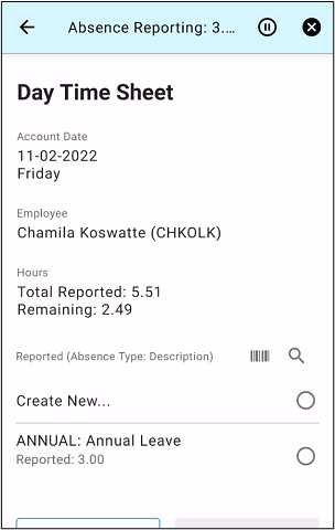

Absence Reporting
Day Time Sheet
Users can see this screen when there is at least one reported absence of the employee on the account day.
The Total Reported, and Remaining time are shown (in unit 'hour') on the account day for the employee.
The drop-down list contains the reported transaction records from IFS.
  • To edit any of the records, select it and click Next
  • To report a new absence, select the 'Create New...' option and click Next
