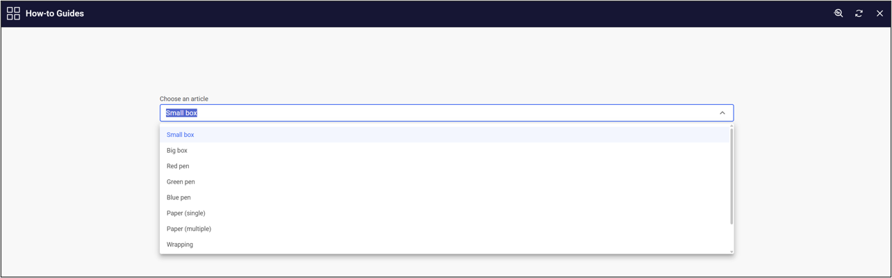

3. Click the **Play** button in the top right-hand corner to run the application in diagnostic mode.
<figure><img src="https://1716064794-files.gitbook.io/~/files/v0/b/gitbook-x-prod.appspot.com/o/spaces%2FIIgl6sNaTky0iALxYWHH%2Fuploads%2FTx4khdaDTaTw04e69ngu%2FMenu%20selection.png?alt=media&amp;token=7d39855a-76c8-4049-a239-f1621d334aae" alt=""><figcaption><p>The Large Row Text shows the articles names. The table is displayed in a drop down menu.</p></figcaption></figure>
<figure><img src="https://1716064794-files.gitbook.io/~/files/v0/b/gitbook-x-prod.appspot.com/o/spaces%2FIIgl6sNaTky0iALxYWHH%2Fuploads%2FEodpj9iHXGnjOeRirwDL%2FMenu%20selection2.png?alt=media&amp;token=bdf90114-87ba-4f84-87f3-f6c2d43cfb5b" alt=""><figcaption><p>All articles displayed.</p></figcaption></figure>

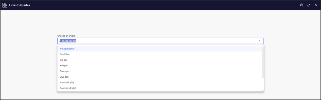

The Menu selection input enforces a selection by not giving an empty option. If you wish to leave the variable empty, you need to add an Empty Option.
2. Go back to the Designer.
   1. Under the Empty Option section, check the "Show Empty Option" checkbox.
   2. Set the Text of Empty Option to "Not applicable".
   3. Check the "Allow Empty Option Selection" checkbox.&#x20;
   4. Run the application in diagnostic mode again.
   <figure><img src="https://1716064794-files.gitbook.io/~/files/v0/b/gitbook-x-prod.appspot.com/o/spaces%2FIIgl6sNaTky0iALxYWHH%2Fuploads%2F5AUwGySiTuekoxFIZMP1%2FMenu%20selection3.png?alt=media&amp;token=8ef58429-ad1d-4e26-bee9-bdd702c3607f" alt=""><figcaption><p>There is now a Not applicable option, allowing the user to not choose one of the articles to move forward.</p></figcaption></figure>

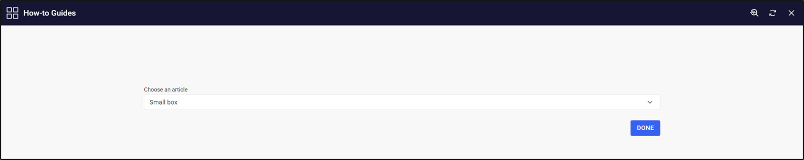

3. You can also set a default value to display the value you wish to highlight.
   1. Under Behaviour, in Default Value, write "{"Small box"}".
   2. Click the **Play** button in the top right-hand corner to run the application in diagnostic mode.
<figure><img src="https://1716064794-files.gitbook.io/~/files/v0/b/gitbook-x-prod.appspot.com/o/spaces%2FIIgl6sNaTky0iALxYWHH%2Fuploads%2Fa8A6fBoQHFe6MwRj5vbP%2FMenu%20selection4.png?alt=media&amp;token=a725dfa0-04c8-4bf0-b7c2-a0cdd0b787e3" alt=""><figcaption><p>The small box is now shown as chosen value. </p></figcaption></figure>

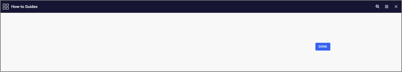

3. Condition to hide&#x20;
   1. In the Condition To Hide, write “{userId = “*your user id”*} *(the user Id you log in to Connect with)*
   2. Run the application in diagnostic mode again.
<figure><img src="https://1716064794-files.gitbook.io/~/files/v0/b/gitbook-x-prod.appspot.com/o/spaces%2FIIgl6sNaTky0iALxYWHH%2Fuploads%2F30JbA6gLpdXaMHuSOvLR%2FWith%20border.png?alt=media&amp;token=589bec14-8458-499f-ac8b-73b3da8387ab" alt=""><figcaption><p>The list is now hidden since the condition is fulfilled.</p></figcaption></figure>
