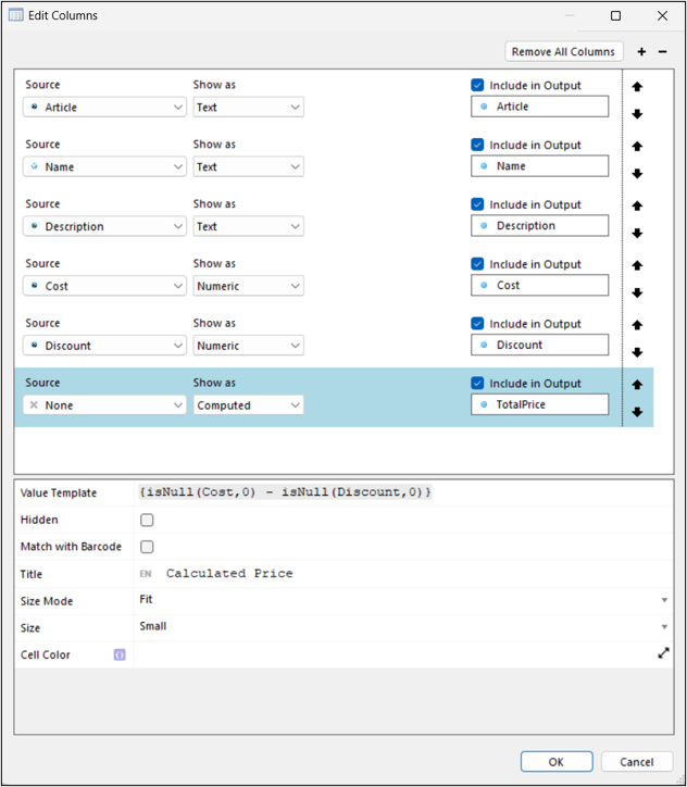

   4. In the Columns, choose "Edit" to the far right.
<figure><img src="https://1716064794-files.gitbook.io/~/files/v0/b/gitbook-x-prod.appspot.com/o/spaces%2FIIgl6sNaTky0iALxYWHH%2Fuploads%2FMjciKCly54544PedQma9%2FData%20grid.png?alt=media&amp;token=2f678cac-a5c6-4d5f-b258-314ff7028693" alt=""><figcaption></figcaption></figure>
5. Choose "Add All Columns".
   1. Article column:
      1. Check the Hidden checkbox.&#x20;
   2. Name column:
      1. Set the Size to Medium.&#x20;
      2. In the Cell Color, write "{"GREEN"}".
   3. Description column:
      1. Set the Size Mode to Break.
   4. Cost column:
      1. Edit the Show as to Numeric.
   5. Discount column:
      2. Check the Editable-checkbox.
   6. Add a new column, by pressing the + button in the top right corner.&#x20;
      1. Set Show as to Computed.
      2. Check the Include in Output-checkbox.
      3. Set the Variable to "TotalPrice".
      4. In the Value Template, write "{isNull(Cost,0) - isNull(Discount,0)}"
      *Flow engine cannot promise that the Qty-variable is not null. And you cannot multiply with nothing. By adding isNull, we tell the Flow engine what to do if it would be a null value.*
      1. Set the Title to "Discounted price".
      2. Set the Cell Color to "{"#8cd3ff"}".
   7. Click OK to go back.&#x20;

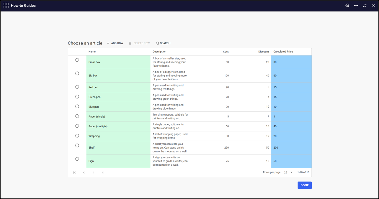

9. Click the **Play** button in the top right-hand corner to run the application in diagnostic mode.
<figure><img src="https://1716064794-files.gitbook.io/~/files/v0/b/gitbook-x-prod.appspot.com/o/spaces%2FIIgl6sNaTky0iALxYWHH%2Fuploads%2Fr5F0FD8q8Pnw50TKnFEl%2Fdata%20grid%203.png?alt=media&amp;token=1f383d51-384d-4c6d-bc52-8bac0da2cbfc" alt=""><figcaption><p>The datagrid shows all articles, columns and the calculated price column. You can add a new row by pressing the + button above the data grid.</p></figcaption></figure>

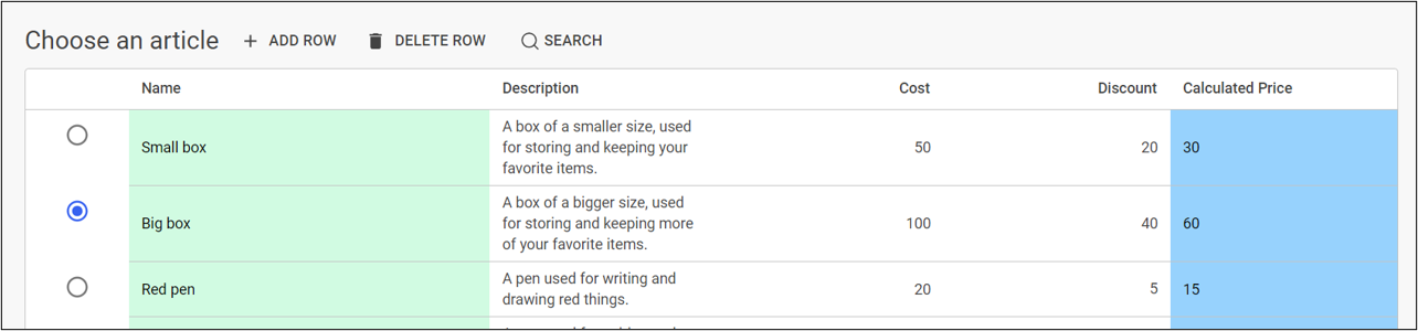

<figure><img src="https://1716064794-files.gitbook.io/~/files/v0/b/gitbook-x-prod.appspot.com/o/spaces%2FIIgl6sNaTky0iALxYWHH%2Fuploads%2FkkU6u3L11TN3yGCumDXe%2Fdata%20grid%204.png?alt=media&amp;token=67dd54bc-97f9-4d63-aa00-bc59ad56de8a" alt=""><figcaption><p>Once a row is marked, the Delete Row option becomes available. </p></figcaption></figure>

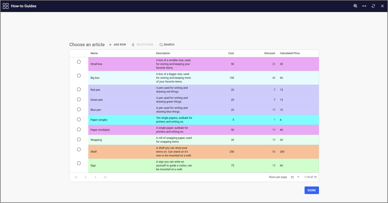

   1. Run the application in diagnostic mode again.
   <figure><img src="https://1716064794-files.gitbook.io/~/files/v0/b/gitbook-x-prod.appspot.com/o/spaces%2FIIgl6sNaTky0iALxYWHH%2Fuploads%2FKDhEkV1tn78KGN0jGacU%2Fdata%20grid%205.png?alt=media&amp;token=fc66e4ce-1a0e-424d-98ce-028b8c2da086" alt=""><figcaption><p>The colors are now for each row, instead of the columns. </p></figcaption></figure>
