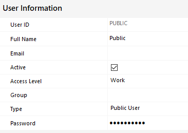

**Environment - Users:** Make sur you have user of the type Public User in your Flow environment with a strong password (that you have access to). &#x20;

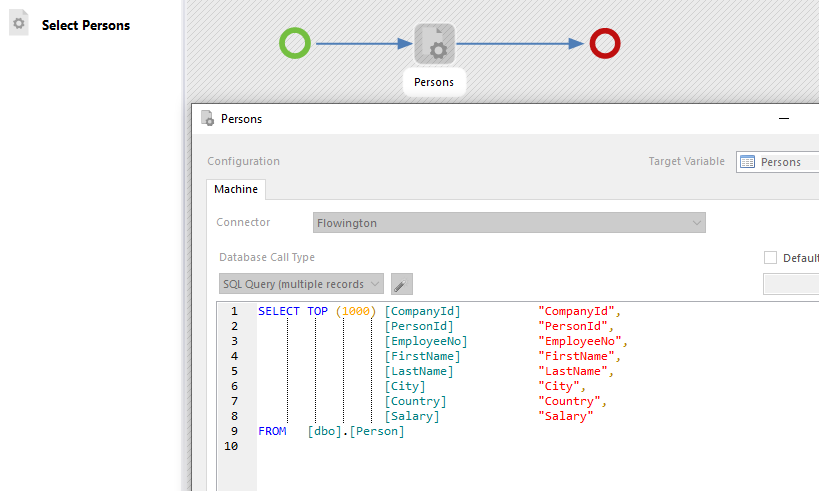

Create a new Machine Flow with a Machine step to fetch some data from a table. &#x20;
<div align="left"><img src="https://3010335096-files.gitbook.io/~/files/v0/b/gitbook-x-prod.appspot.com/o/spaces%2F-MjcNODv1kQRDGTj76t9%2Fuploads%2Fr8fWChRY4zYQuRxAYtcs%2Fimage.png?alt=media&amp;token=5965c53c-34e8-480e-b15b-98f2e4077f46" alt=""></div>
```sql
SELECT TOP (1000) [CompanyId]           "CompanyId",
                  [PersonId]            "PersonId",
                  [EmployeeNo]          "EmployeeNo",
                  [FirstName]           "FirstName",
                  [LastName]            "LastName",
                  [City]                "City",
                  [Country]             "Country",
                  [Salary]              "Salary"
FROM   [Person]

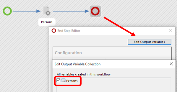

Connect the result of your query to the ouput variables (red ring)

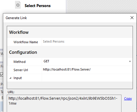

Right click on your Flow and choose to **Generate Web Link** and copy the url

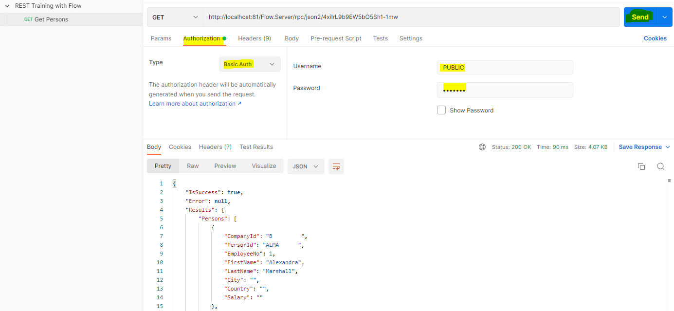

## Query your API - GET
#### From Postman
Open Postman, create a new workspace that you call "REST Training with Flow", and under that collection add a new request as a GET request, pointing to the url you just generated in Flow.&#x20;
Under Authentication, choose Basic Auth and enter the username and password for your public user in Flow and press Send to make sure you get some data back and a Status 200 OK  &#x20;
![](https://3010335096-files.gitbook.io/~/files/v0/b/gitbook-x-prod.appspot.com/o/spaces%2F-MjcNODv1kQRDGTj76t9%2Fuploads%2FV4l3x7pNsEK8Tntw6LaS%2Fimage.png?alt=media\&token=f2e4f42c-d353-4c91-99c7-9a6f2e15019a)
Congratulations, you have now build a REST API using Flow, and mastered Postman to successfully query the API (i.e., your Flow) getting a Response Status 200 OK with values.&#x20;

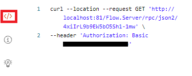

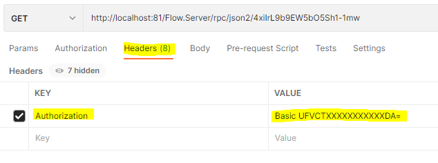

What the Basic Authentication actually does is encoding the username and password in to an encoded string, and applying that in the request header with Authorization as Key and the encoded string as Value.&#x20;
![](https://3010335096-files.gitbook.io/~/files/v0/b/gitbook-x-prod.appspot.com/o/spaces%2F-MjcNODv1kQRDGTj76t9%2Fuploads%2F5VZwhFsPTcuL2xv4wRUO%2Fimage.png?alt=media\&token=7c4eedf9-9ca9-472d-85c9-11878ed9cb18)
In other words, you can choose No Auth under Authorization and instead manually apply the Authorization to the request header. Just to understand the technology

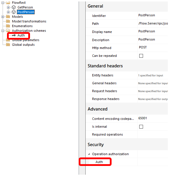

In Flow you can set the Username and Password for basic authentication on the connector (see image further below), and then create an Authorization scheme that you connect to your operations.&#x20;
<div align="left"><figure><img src="https://3010335096-files.gitbook.io/~/files/v0/b/gitbook-x-prod.appspot.com/o/spaces%2F-MjcNODv1kQRDGTj76t9%2Fuploads%2F8k0LKSYAT5CK52kKLlIt%2Fimage.png?alt=media&amp;token=5f56f74b-05a0-4ca2-8eb8-54c8c1d66b00" alt=""><figcaption></figcaption></figure></div>
Or just as in Postman you can choose to pass an Authorization header with the base64 encoded username:password

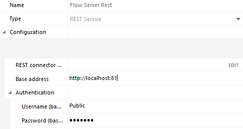

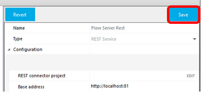

Under **Environment - Connectors**, create a Rest Connector, setting your public user as user under Authentication. The connector will be referred to as "Flow Server REST", so call it the same if you wish. Note that the Base address is just the server part of the url as mentioned earlier. &#x20;
<div align="left"><img src="https://3010335096-files.gitbook.io/~/files/v0/b/gitbook-x-prod.appspot.com/o/spaces%2F-MjcNODv1kQRDGTj76t9%2Fuploads%2F1DLFl9w9pO8wCxQQezP6%2Fimage.png?alt=media&amp;token=bedcc998-4c90-49f6-ba08-04e46085e6e4" alt=""></div>
&#x20;Press the **EDIT** button, this is where we are going to create and manage our REST Project.&#x20;

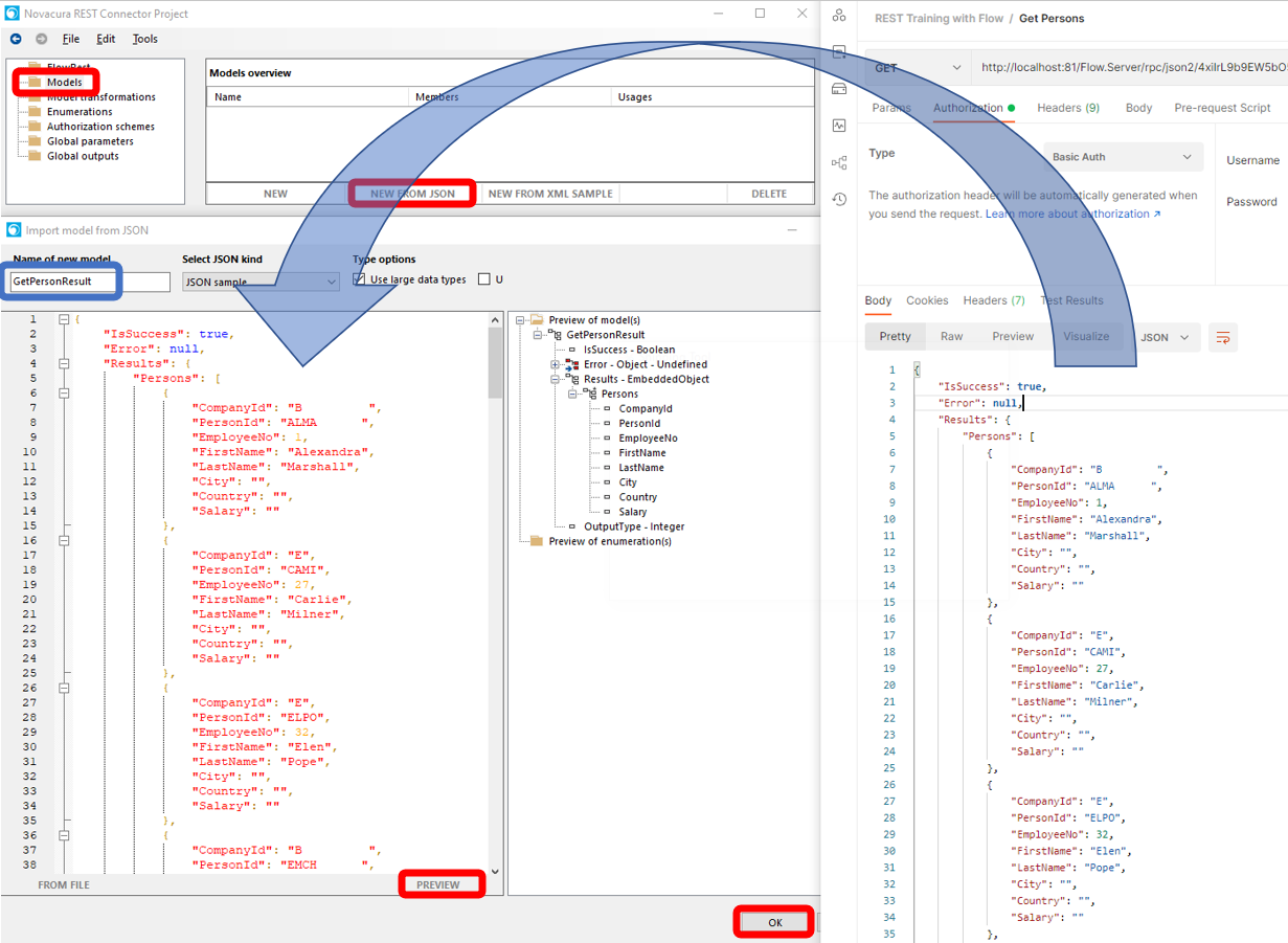

Inside the *Novacura REST Connector Project* Window:&#x20;
* Click on **Models** and then **New From JSON**
* Name the model *GetPersonResult*
* Copy the entire result from Postman into the left pane
* Click **Preview** and verify the result on the right hand side
* Press **OK**
![Creating a model from JSON](https://3010335096-files.gitbook.io/~/files/v0/b/gitbook-x-prod.appspot.com/o/spaces%2F-MjcNODv1kQRDGTj76t9%2Fuploads%2FMdeFjZTTVef2i2QVfu3K%2Fimage.png?alt=media\&token=b3eb2aaf-9daf-41f2-832a-6aa693c8f559)

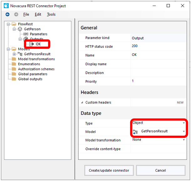

We now have a model of the response body of our request which we will connect to an operation. Create a New Operation that you call GetPerson, with the path that is the same you were using in Postman except the Base address.&#x20;
![](https://3010335096-files.gitbook.io/~/files/v0/b/gitbook-x-prod.appspot.com/o/spaces%2F-MjcNODv1kQRDGTj76t9%2Fuploads%2Fgmws20RveRQF4LD8XqSE%2Fimage.png?alt=media\&token=203799fb-007e-4b42-85e3-e24a030c6163)
And here comes the kicker that is hard to miss, we want to capture the result in to our model that we have created, do so by select Object as type and our Model under the output like so:&#x20;
<div align="left"><img src="https://3010335096-files.gitbook.io/~/files/v0/b/gitbook-x-prod.appspot.com/o/spaces%2F-MjcNODv1kQRDGTj76t9%2Fuploads%2Fn4NlggWvbAV4O3hTVlXO%2Fimage.png?alt=media&amp;token=77b87cf9-3c2e-48cc-9622-2c62bca28185" alt=""></div>
![](https://3010335096-files.gitbook.io/~/files/v0/b/gitbook-x-prod.appspot.com/o/spaces%2F-MjcNODv1kQRDGTj76t9%2Fuploads%2FwYaHBG7SxIejukVxY1Zo%2Fimage.png?alt=media\&token=55ae1099-39cf-4361-9846-b2865117f9ac)

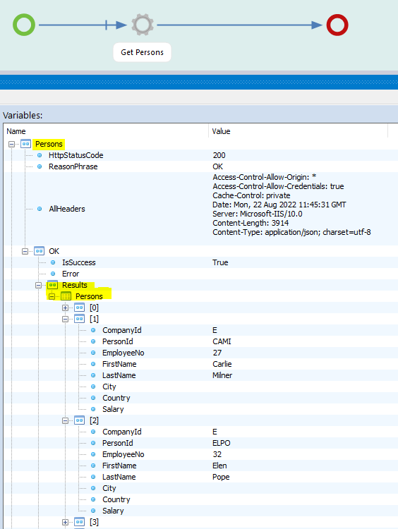

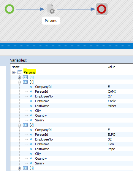

Running our workflow now in the debugger should give us a similar response as when running the first workflow that fetched the data directly from SQL, with the difference that we get the response in a more No-SQL format (not only straight tables, but where a record can contain a record that contain a table etc. More of a JSON structure) &#x20;
<div align="left"><img src="https://3010335096-files.gitbook.io/~/files/v0/b/gitbook-x-prod.appspot.com/o/spaces%2F-MjcNODv1kQRDGTj76t9%2Fuploads%2FMbQ1F0zrbyXHMUYi8srE%2Fimage.png?alt=media&amp;token=c081d334-662b-4fb7-95de-f5e662a32eb1" alt=""></div>
Note also that the response comes in under the *OK* variable under *Persons*, just as how we mapped the Operation when we built the connector project. While 200 - OK is the most common code that indicates a successful operation it might differ. So it is important to check the documentation for the REST API for what to expect.&#x20;

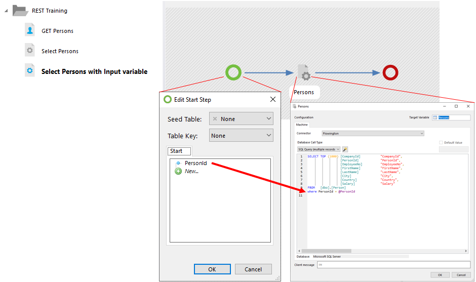

Make a copy of you Select Persons workflow (the machine flow that queries the database) and call it "Select Persons with Input variable"
Edit the green ring and add a variable that is called PersonId, and use that in your SQL Query for the where clause as shown below:&#x20;

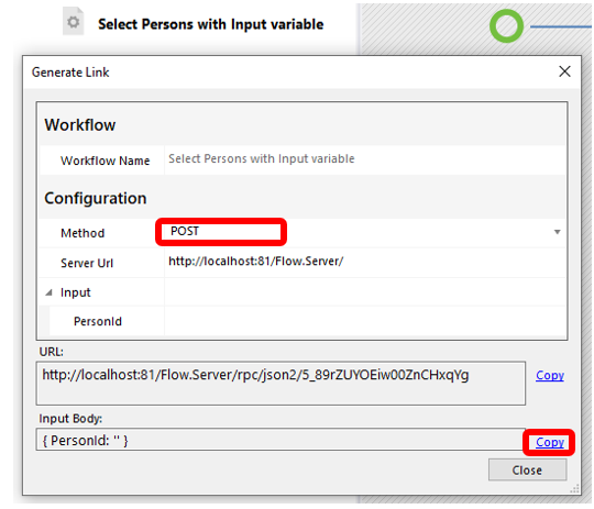

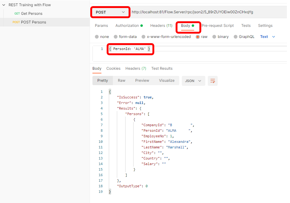

Right click on the newly created workflow and choose "Generate web link", but this time select POST as the method and copy the input body
<figure><img src="https://3010335096-files.gitbook.io/~/files/v0/b/gitbook-x-prod.appspot.com/o/spaces%2F-MjcNODv1kQRDGTj76t9%2Fuploads%2FFDsQVJzzuxXSoVXFnazs%2Fimage.png?alt=media&amp;token=a2daab06-3c2f-4528-a577-7cb993b37c10" alt=""><figcaption></figcaption></figure>
Over in Postman, create a duplicate of your "Get Persons" operation, change it to a POST command and paste your copied Input Body in to the body of the request. Set the input variable to 'ALMA' and try to send your request. It should yield a result of only one record (the person ALMA)&#x20;

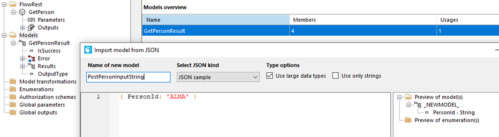

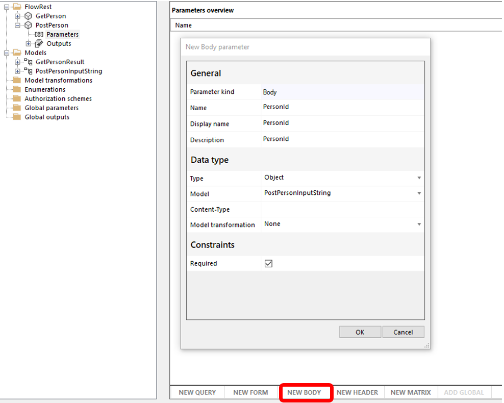

To do the same in Flow, go back in under your REST Project and:&#x20;
* create a new model&#x20;

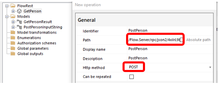

* a new operation with your new workflow as path and POST method..&#x20;
  * ..and with your newly created model as a body input parameter.&#x20;
<div align="left"><figure><img src="https://3010335096-files.gitbook.io/~/files/v0/b/gitbook-x-prod.appspot.com/o/spaces%2F-MjcNODv1kQRDGTj76t9%2Fuploads%2FVNSFOoVJkEN3ecvJjmMt%2Fimage.png?alt=media&amp;token=90185904-ce42-4424-8600-692101052b00" alt=""><figcaption></figcaption></figure></div>
<figure><img src="https://3010335096-files.gitbook.io/~/files/v0/b/gitbook-x-prod.appspot.com/o/spaces%2F-MjcNODv1kQRDGTj76t9%2Fuploads%2F4BW7dwQbyr3reczWLJUP%2Fimage.png?alt=media&amp;token=fb0d8a8f-eae5-4a72-af6e-29f8d7ce087b" alt=""><figcaption></figcaption></figure>
<figure><img src="https://3010335096-files.gitbook.io/~/files/v0/b/gitbook-x-prod.appspot.com/o/spaces%2F-MjcNODv1kQRDGTj76t9%2Fuploads%2FHldY9PtNDQoVHf9M83jz%2Fimage.png?alt=media&amp;token=83173bb0-a666-4a83-add2-391d7c9bcda6" alt=""><figcaption></figcaption></figure>
Duplicate your Get Persons workflow and call it POST Persons, double click the cog wheel and change the operation to you new PostPersson operation (do not forget "refresh").  Execute the workflow and validate that you get the same result as with Postman.&#x20;
