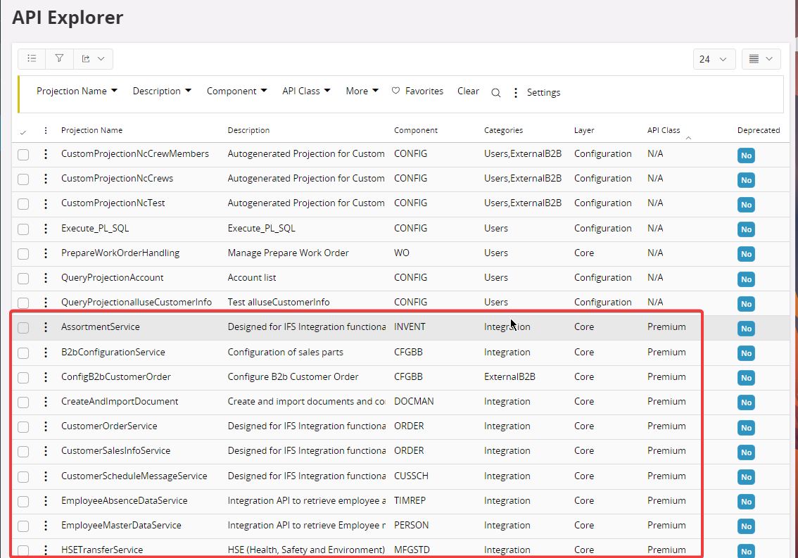

## Projections
The OData services within IFS are called **Projections**. Projections in are sets of API methods that, in most cases, correspond to a specific page in Aurena. There are for example projections that are designed completely for 3rd party integrations. But most of the 5500+ projections are to support the Aurena functionality, just as packages mainly supported functionally in the Enterprise Explorer in pervious versions.&#x20;
There are different categories of projections, apart from the standard projections, in IFS cloud.&#x20;
### Custom Projection
As the name indicates this category of Projections is not standard to IFS. Custom Projection is the result of **Projection Configuration** or by deploying a **Utility Package** in the database. This can then be exposed as an Custom Projection.&#x20;
### Premium Projections
Premium projections is offered by IFS as a complement to standard projections. Standard projections are primarily designed to support Aurena pages. Premium projections on the other hand is designed for integrations. Premium Projections replaces the old BizAPIs.
