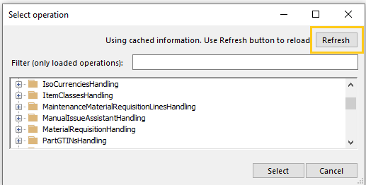

In order for the new projection to appear in Flow studio, refresh the projection list cache in the machine step.  &#x20;
1. Open the step, click ***Refresh***&#x20;
2. The new projection appears in the projection list
