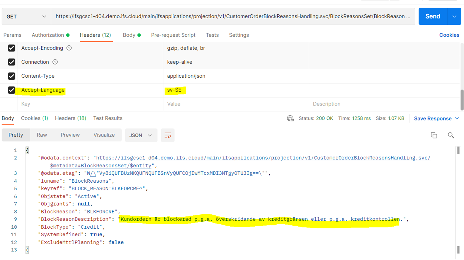

* Basic data translations are supported with Accept-Language header. Returned response body contains the translated text for Block Reason Description.
<figure><img src="https://3323790987-files.gitbook.io/~/files/v0/b/gitbook-x-prod.appspot.com/o/spaces%2FJyIxKYxK0LMJ2T3XubCS%2Fuploads%2FXbULbGW43W9RVki4HF9N%2Fimage.png?alt=media&amp;token=3c01cf7e-ce04-4030-a6cd-71ec5f9ea600" alt=""><figcaption><p>Basic data translations</p></figcaption></figure>
<figure><img src="https://3323790987-files.gitbook.io/~/files/v0/b/gitbook-x-prod.appspot.com/o/spaces%2FJyIxKYxK0LMJ2T3XubCS%2Fuploads%2FbdFcrSi42YNHxnt2k84O%2Fimage.png?alt=media&amp;token=e9412c1e-72b4-415c-a66a-bdf4173b0c92" alt=""><figcaption><p>Response</p></figcaption></figure>
