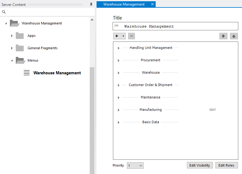

## Menus
Always align menu names with the menu **Title**. Keep all menus under one folder in the Flow Studio folder structure. Think through the content in each menu together with the role setup.
