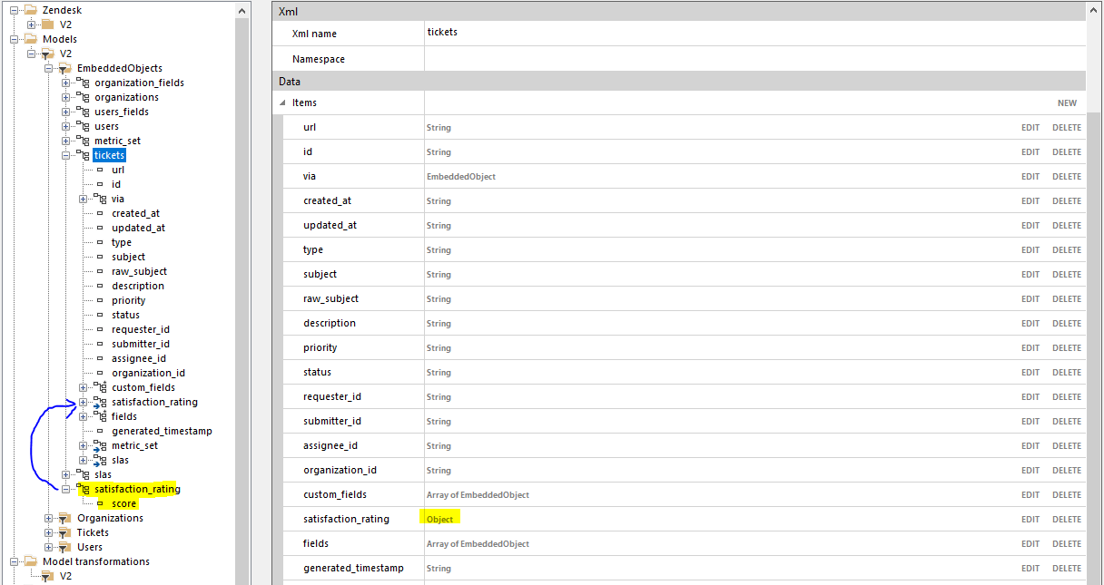

And in the logfiles I could find the position of where the error occurred (e.g. pos. 1673). However, the string I found here was nothing directly weird with: ""satisfaction\_rating":{"score":"unoffered"}".&#x20;
But - my REST model in the Flow Connector had satisfaction\_rating set as a string, while if I decipher the Json-syntax can see that satisfaction\_rating actually is an Object with one Element (score).&#x20;
Updating my model to this made it work again:
![](https://1485304389-files.gitbook.io/~/files/v0/b/gitbook-legacy-files/o/assets%2F-LzBrnkjB1FHaXbUzlzZ%2F-MXpcVcEed_VpfHQhnzn%2F-MXpfE0SxbA_5VUMNNR8%2Fimage.png?alt=media\&token=8cd16482-0c4d-4323-9f42-9667b8960f0a)
So obviously Zendesk changed something on their end, and this is how we isolated the issue and updated it on our end.&#x20;
